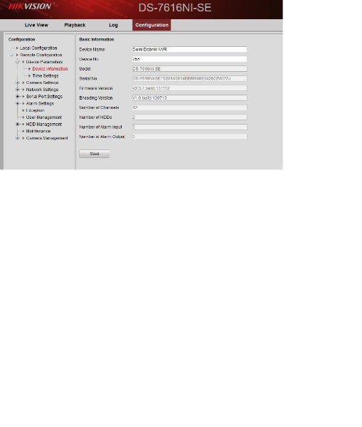

avoida писал(а):Trying connecting the camera to NVR Hikvision series 7616 but without success - Onvif protocol port 80 with different resolutions 4mp,3mp,2mp
7616 firmware version?

Possible you need to use custom mode in you NVR!!!
But first NVR virmware version!

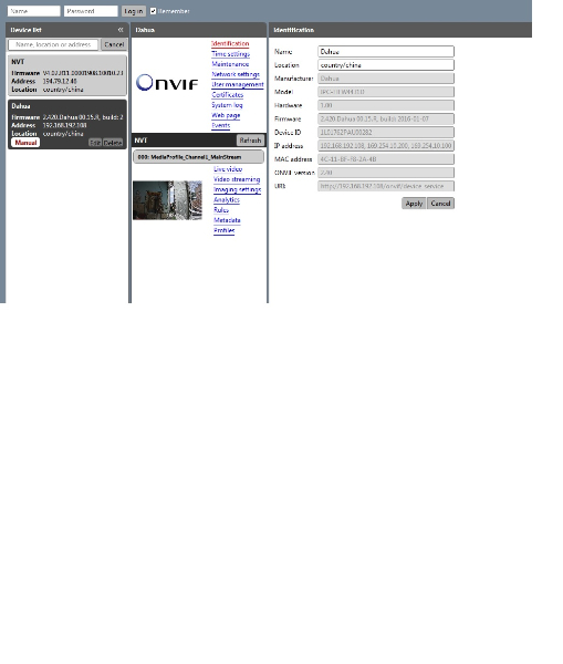

Add photo NVR and IPC Dahua from Onvif DM
Re: Problem connect Dahua IPC-HFW4431D
Сообщение iTuneDVR » 18 май 2016, 17:55
Screenshots quaity is bad!!!

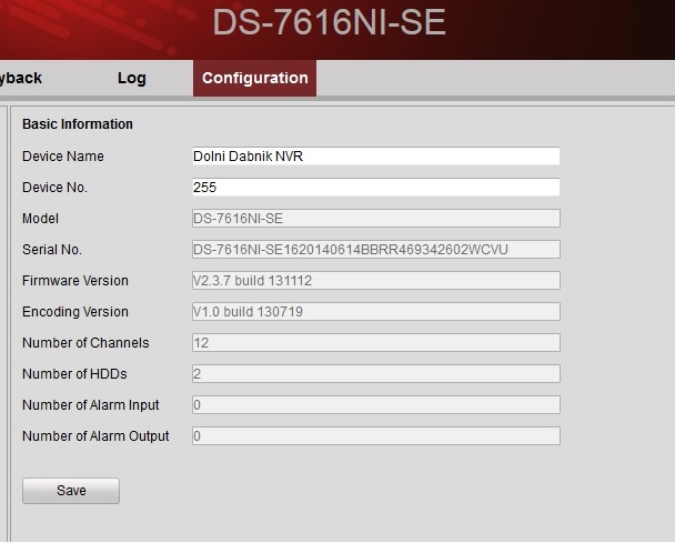

Firmware NVR too old!!!
ONVIF version from IPC is unreadeable!!!

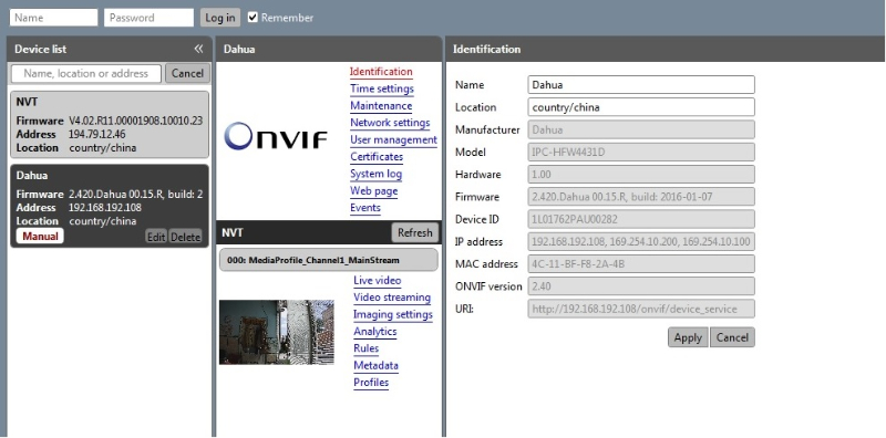

Picture with good quality.
Сообщение iTuneDVR » 18 май 2016, 23:56
Catch Live video on ODM and bottom of window with video & see RTSP string!
Try uprgade NVR firmware!

Why in ODM in Live preview no have picture on Onvif format, picture showing just in MJPEG format./MJPEG is bad /?
Сообщение iTuneDVR » 19 май 2016, 12:32
Make a screenshot from this!. Version of ODM?
You try to upgrade NVR???

if it has updated the firmware of NVR that will become only Chinese language NVR?
where to download the correct firmware?
Onvif device manager is version 2.2.250
